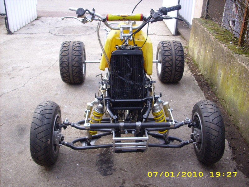

I try to answer : have you thinking to try with a lower kit like this
Maybe is possible to adjust lenght of this to have good result...
